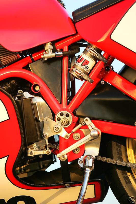

SI TON MONTAGE DE BRAS OSCILLANT EST CORRECT
TU NE DOIT PAS MODIFIER TROP L ASSIETTE DE TA MOTO
EVENTUELLEMENT LA REMONTER LEGEREMENT 1 A 2 CM MAXI SINON TU VAS COMPLETEMENT DESEQUILIBRER TA MACHINE
SI LES POINTS D ANCRAGES DES AMORTISSEURS EN HAUT SUR LA CADRE ET EN BAS SUR LE BRAS OSCILLANT
SONT PLACES DIFFERENMENT DE L ORIGINE
IL FAUT NON SEULEMENT ADAPTER LA LONGUEUR DES AMORTISSEURS EN CONSEQUENCE
MAIS AUSSI LA DURETE ET LA PROGRESSIVITE DES RESSORTS
DANS CERTAINS CAS ON UTILISE MEME 2 RESSORTS DIFFERENTS MONTES BOUT A BOUT
SINON C EST JUSTE UN CAFE RACER BON POUR FAIRE 300 M D UN BISTRO A L AUTRE EN AUCUN CAS UNE MOTO ROULABLE
ET FIABLE
ENCORE MOINS UNE MACHINE DE PISTE
NE PAS OUBLIER QU AU FREINAGE LA ROUE ARRIERE DELESTE JUSQUA SE LEVER SI TU AS DE VRAIS FREINS
CE SONT LES AMORTISSEURS QUI FONT LA BUTEE D EXTENSION ET RIEN D AUTRE
ENSUITE SUR LES MOTOS DE COURSE ON ADAPTE LA HAUTEUR DE L AXE DE BRAS OSCILLANT PAR RAPPORT AU CADRE
MAIS CELA NE CONCERNE PAS UN MONTAGE COMME LE TIENS A MOINS DE PROFONDES TRANSFORMATIONS
