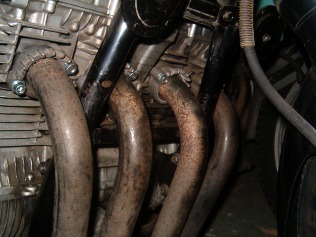

QUELQUES BRICOLES
BOUCHON DE VIDANGE SERRE PAR UN BOURRIN ...FILETAGE FOIRE1100 GSX ESD YVES  - Page 3 679130
DEMONTAGE DES ECHAPPEMENTS
VIDANGE
DEMONTAGE ET REMPLACEMENT DU CARTER INFERIEUR
REMPLACEMENT DU FILTRE A HUILE ET DU JOINT TORIQUE EN MARGUERITTE
REMONTAGE DE L ECHAPPEMENT AVEC LES COLLERETTES CENTRALES D ORIGINE EN ALU
1100 GSX ESD YVES  - Page 3 1100_g13
COMMANDE DES VIS PLATINEES ET CONDENSATEURS NEUFS DE GS 1000
POUR REMPLACER LE PLATEAU D ALLUMAGE "SORTI DE LA MER"
A SUIVRE
