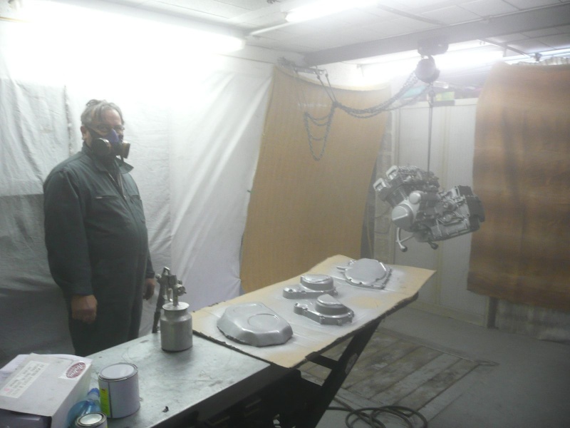

| IL Y A 3 ECOLES ET 3 SOLUTIONS J AI TESTE LES 2 PREMIERES AVEC SUCCES LA DERNIERE JE N AI JAMAIS EU LE COURAGE LA PREMIERE QUAND ON DEMONTE TOUT DANS LES REGLES DE L ART SURTOUT QUAND ON FAIT UNE PEINTURE COULEUR ALU COMME SUR LES MOTEURS HONDA OU LES Z 1000 A KICK ON UTILISE UNE PEINTURE A HAUTE TEMPERATURE SURTOUT POUR LA CULASSE SINON ON A DES SOUCIS DE JAUNISSEMENT MAIS POUR LA FAIRE SECHER CORRECTEMENT IL FAUT L'ETUVER DANS LE FOUR DE LA CUISINIERE ... DE PREFERENCE EN SON ABSENCE ET METTRE UN COUP DE PYROLISE APRES ... CELA PLANQUE L ODEUR LE BAS MOTEUR LES CARTER ET MEME LE BLOC CYLINDRE NE CHAUFFE JAMAIS SUFFISAMENT POUR FAIRE CLOQUER LA PEINTURE LA SECONDE METHODE SURTOUT POUR LES MOTEURS NOIR ON PEUT SE PERMETTRE DE PEINDRE L ENSEMBLE AVEC UN PEINTURE EN BOMBE SATINEE DE BONNE QUALITE ENVIRON 7 A 8€ LA BOMBE UNE SUFFIT A FAIRE LA BASE MOTEUR UNE SECONDE POUR TOUS LES CARTERS L AVANTAGE C EST QUE L ON PEUT FAIRE UNE RETOUCHE SANS TROP DE PROBLEME C EST ASSEZ INVISIBLE LA TECHNQUE EST TOUJOURS LA MEME 2 A 3 COUCHES MOUILLE SUR MOUILLE OU ALORS ATTENDRE 48 H QUE LA COUCHE DE BASE SOIT PARFAITEMENT SECHE LES SOLUTIONS INTERMEDIAIRES SONT SOUVENT CATASTROPHIQUES STYLE CRAQUELURES OU COULURES PAR CONTRE LA PREPARATION EST FASTIDIEUSE ET DURE 4 A 5 HEURES 1 LAVAGE AU KARCHER A L EAU CHAUDE ET DETERGENT LA MEILLEURE SOLUTION AUJOURD HUI DANS LES CENTRES DE LAVAGES STYLE "L ELEPHANT VERT " IL Y A DES PRODUITS POUR DECAPER LES JANTES ALU TRES PUISSANTS C EST ASSEZ EFFICACE POUR LE NETTOYAGE DU MOTEUR ENSUITE JE N AI JAMAIS TROUVE MIEUX QUE LE PINCEAU ET L ESSENCE F OU LE WHITE SPIRIT ET C EST TRES LONG ENTRE TOUTES LE AILETTES ET DERRIERE LES CARTERS ENFIN UN GRANDE BOMBE DE NETTOYANT FREIN POUR TOUT FINIR DE DEGRAISSER PARFAITEMENT AVEC ESSUYAGE AU CHIFFON DANS TOUS LES RECOINS LA QUALITE DE LA PREPARATION CORRESPOND AU RESULTAT FINAL .... ENFIN AUTRE SOLUTION POUR LES MOTEURS COULEUR ALU C EST RESERVE AUX LES GRANDS MALADES C EST LE DECAPAGE COMPLET JUSQU A L ALU ET POLISSAGE ON EN A VU PASSER PLUSIEURS MOIS A LA DREMEL ...C EST AUSSI UNE SOLUTION ET C EST MAGNIFIQUE ...LE TRAVAIL DE DIDI SUR LES Z 1000 VOILA VOUS SAVEZ TOUT A+ YVES |

| NE PAS CONFONDRE PEINTURE EPOXY ET HAUTE TEMPERATURE CELA N EST PAS FORCEMENT LA MEME CHOSE ... DE LA PEINTURE EPOXY EN POUDRE SUR UNE CULASSE C EST PAS BON ET EN PLUS CELA SE RAMOLI A LA CHALEUR AUX ALENTOURS DE 180° A MOINS QU ELLE SOIT PREVU SPECIFIQUEMENT POUR LES HAUTES TEMPERATURES ET LA C EST SOUVENT EN BI COMPOSANT ET DELICAT A APPLIQUER LA FACILITE RESTE POUR UN AMATEUR L UTILISATION DE PRODUITS EN BOMBE A+ YVES |

| RESTOM fait des kits de peinture 2 composants de très bonne qualité , l'investissement est justifié (noir ou gris) a faire au pistolet après tous les nettoyages cités par YVES. .  |

| +1 j'ai utilisé la Restom noir bi-composants c'est que du bonheur et la spéciale moteur à refroidissement à air pour cylindres/culasse. Avec un kit j'ai fait le moteur du Z et quasi 3 moteurs de 125  |

| JE CONFIRME J AI DEJA UTILISE LEUR PRODUIT BICOMPOSANT C EST TRES PERFORMANT MAIS NECESSITE TOUT DE MEME UN PEU DE MATERIEL LE PISTOLET EST INDISPENSABLE SI ON VEUT OBTENIR UN RENDU CORRECT AU PINCEAU C EST DIFFICILEMENT REALISABLE UN BEMOL TOUT DE MEME A NE JAMAIS UTILISER SUR UN RADIATEUR D HUILE IL VA PERDRE UNE PARTIE DE SES QUALITES DISSIPATRICE DE CALORIE POUR TERMINER SUR LE SUJET LE MUST POUR LES MOTEURS DE COURSE C EST LE CELEBRE KAL-GARD ENTRE GRIS FONCE ET NOIR MAT QUI LUI EST ETUDIE POUR MIEUX DISSIPER LES CALORIES DU MOTEUR UTILISE A L ORIGINE DANS L AVIATION ET L ARMEE LE MERITE DE L UTILISATION EN REVIENT COMME SOUVENT A MR YOSHIMURA SUR SES PREPARATIONS DES ANNEES 80 A+ YVES |

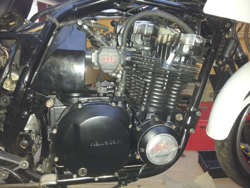

 | Sujet: Re: 1100 ZX YVES 8/6/2014, 16:26 | |
| je vois que ça avance entre deux parties de baby foot ! le moteur est dans le cadre !.Joli boulot  |

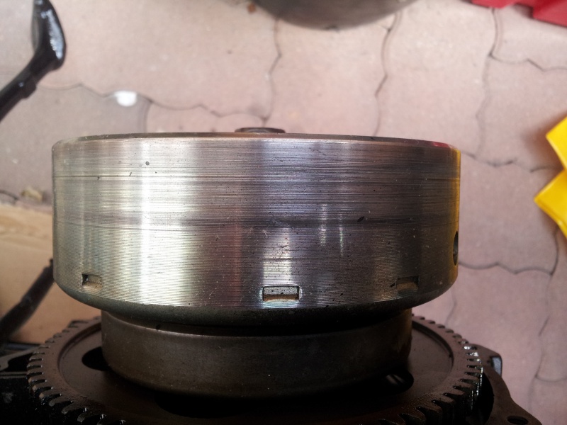

| PETITE PRECISION POUR LE REMONTAGE DE L ALTERNATEUR SUR LES MODELES Z 1000 ST MKII ET H AINSI QUE TOUS LES SUIVANTE DE LA 1000 J R 1100 GPZ B1 B2 ET ZX 1100 LE MONTAGE DE LA PLAQUE DE GUIDAGE DES FILS DU STATOR DOIT ETRE CORRECTEMENT POSITIONNEE DERRIERE LES 2 ERGOTS DE FONDERIE  J EN AI VU SOUVENT DE MAL MONTEES APRES CELA DONNE CA  LA LIMAILLE DANS LE MOTEUR MOI J AIME PAS TROP A+ YVES |

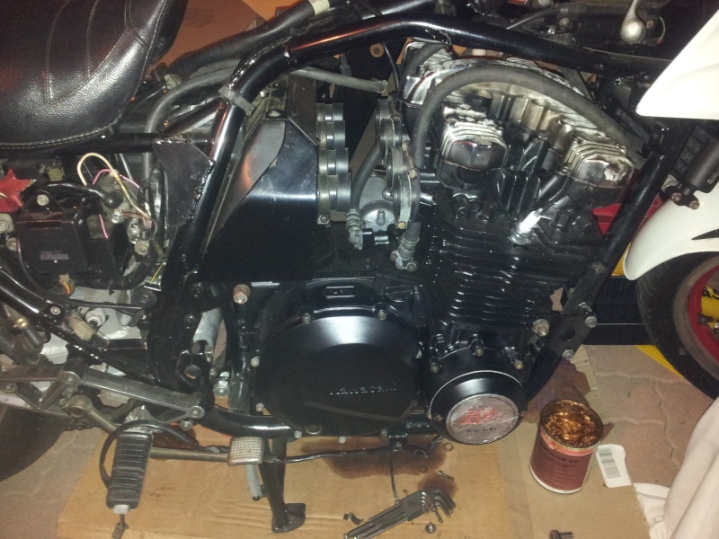

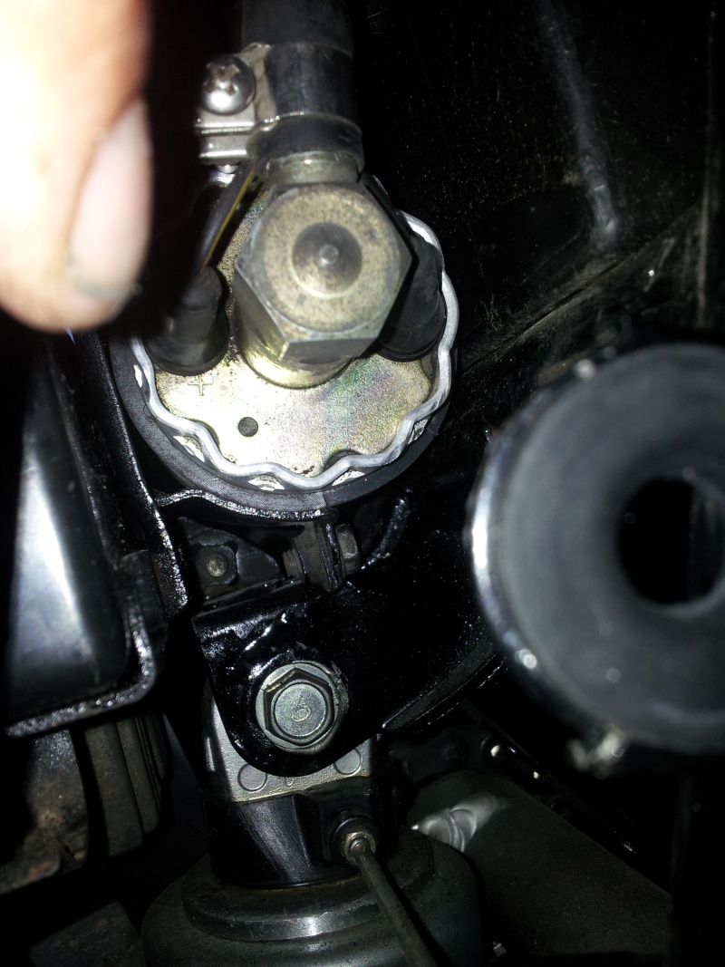

| CELA SE COMPLETE REMONTAGE DE L ALTERNATEUR... MAINTENANT QUE LA TOLE NE TOUCHE PLUS C EST BEAUCOUP MIEUX  DEMARREUR CONTROLE DES 4 CHARBONS CAR CE MODELE SUR LE ZX 1100 EST BEAUCOUP PLUS PUISSANT IL A UN DOUBLE ENROULEMENT REMONTAGE DU RADIATEUR D HUILE ET SES DURITES POUR INFORMATION LE RADIATEUR A ETE NETTOYE ET REPEINT AVEC DE LA PEINTURE HAUTE TEMPERATURE MATE POUR NE PAR PERDRE EN ECHANGE DE CALORIE UNE PEINTURE NORMALE N EST PAS RECOMMANDEE CAR ELLE A TENDANCE A ISOLER LE RADIATEUR DE L AIR... CE N EST PAS LE BUT PUIS MISE EN PLACE DE LA BOITE A AIR C EST TOUJOURS UN CHALLENGE  DE L AUTRE COTE POMPE A ESSENCE LA MISE EN PLACE EST LIMITE IMPOSSIBLE LE COLLIER S OUVRE AVEC LA VIS VERS LE BAS ENTRE LE CADRE ET LE BAC A BATTERIE C EST UNE FOLIE A RESSERRER 1/8 DE TOUR PAR 1/8 DE TOUR AVEC UNE CLE PLATE MEULEE IL N Y A PAS INTERET A DEVOIR Y REVENIR J AI TESTE LA POMPE A ESSENCE AVANT  HEUREUSEMENT J EN AVAIS UNE QUI ETAIT COLLEE  AVEC LES RESIDUTS D ESSENCE IL FAUT QUE JE LA PASSE AUX ULTRA SONS POUR TENTER DE LA RECUPERER LES PIPES D ADMISSION NEUVES EN PLACE ...YA INTERET CAR AVEC DES PIPES DURES COMME DU BOIS IL EST IMPOSSIBLE DE RENTRER LA RAMPE D INJECTION ET DE PLUS LES PRISES D AIR SONT CATASTROPHIQUES SUR UNE INJECTION C EST LE SERRAGE ASSURE  OU UN TROU DANS LE PISTON ... AU CHOIX  J AI ENSUITE ATTAQUE LES RAMPES D INJECTION ET LA C EST PAS COOL DU TOUT AVEC LES NOUVELLES ESSENCES DECOMPOSEES LES INJECTEURS SONT COLLES SUR 16 J AI REUSSI A EN SAUVER 5 HEUREUSEMENT QU IL N Y A QUE 4 CYLINDRES SUR CELLE CI  SINON J ETAIS MARRON JE VAIS LAISSER TEMPER LES AUTRES POUR VOIR SI J ARRIVE A EN SAUVER ENCORE QUELQUES UNS MAIS C EST PAS GAGNE A+ YVES |

une tôle fine devant les pipes d admission une tôle fine devant le filtre a air et au milieu je glisse ma rampe de carburateurs puis j enlève les tôles une par une et sa le fait tous seul |

une tôle fine devant les pipes d admission une tôle fine devant le filtre a air et au milieu je glisse ma rampe de carburateurs puis j enlève les tôles une par une et sa le fait tous seul BELLE IDEE  MERCI DOMINICK JE VAIS METTRE EN PRATIQUE D ICI PEU JE VOUS DONNE DES NOUVELLES DU RESULTAT A+ YVES |

| JUSTE POUR VOUS MONTRER OU CE TROUVE LA SATANEE VIS DU COLLIER DE LA POMPE A ESSENCE ... IL NE FAUT JAMAIS AVOIR A Y REVENIR SINON JE VOUS DIT PAS LE DEMONTAGE  POUR LA RAMPE D INJECTION ELLE EST EN PLACE SANS TROP DE DIFFICULTES J AI MIS UNE PLAQUE EN TOLE COTE MANCHONS ET CELA S EST PLUTOT BIEN PASSE MERCI DOMINIK ON VA PAS DIRE QUE CELA S EST MONTE TOUT SEUL NON PLUS MAIS EN 1/2 HEURE C ETAIT POSITIONNE CORRECTEMENT  VOILA ON TOUCHE AU BUT COTE MOTEUR  IL Y A ENCORE PAS MAL DE BOULOT AU NIVEAU CIRCUIT ELECTRIQUE POUR TOUT BRANCHER ET METTRE AU PROPRE A+ YVES |
