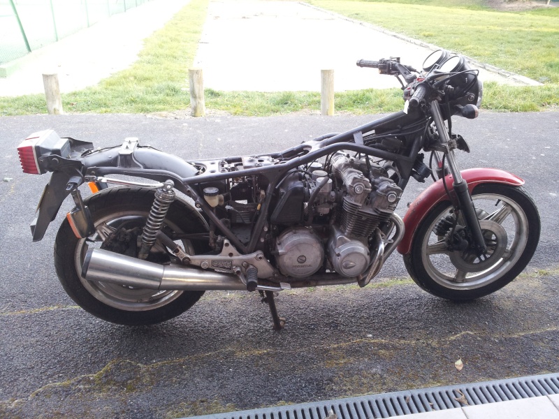

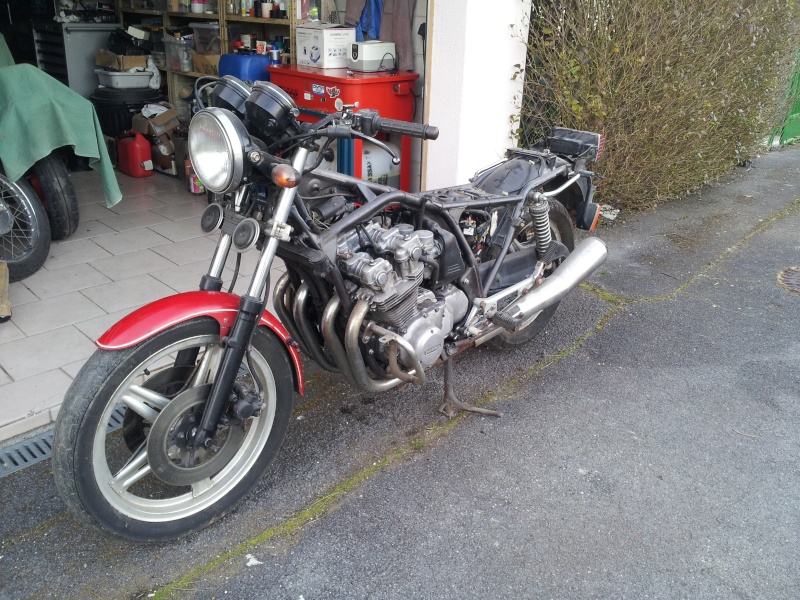

| VOILA UN NOUVEAU CHANTIER DE REMISE EN ROUTE D UNE 900 BOL D OR PREMIERE SERIE DE 1979 MODELE FZ SC01 LE CADRE ET LE MOTEUR SONT DANS LES 2000 A QUELQUES NUMEROS D INTERVALLE DONC C EST SON MOTEUR D ORIGINE C EST PARFAIT ELLE EST DANS SON JUS ET MERITE UN REDEMARRAGE ET UNE REMISE EN ETAT CAR LES 900 BO SONT DE PLUS EN PLUS RARE A ETRE COMPLETES ET D ORIGINE ELLE A MEME SON GARDE BOUE ARRIERE LONG AVEC SON CATADIOPTRE ... C EST DIRE  LA VOICI CHEZ LE DOCTEUR   QUELQUES DETAILS AVANT LA REMISE EN ROUTE DEMONTAGE DU BAC A HUILE ET CONTROLE DE LA CREPINE VIDANGE ET REMPLACEMENT DU FILTRE A HUILE SONT UN MINIMUM A+ YVES

| C EST UNE DEUXIEME MAIN QUI A ETE ARRETEE EN 2007 SOIT IL Y A PRESQUE 10 ANS ET SON SECOND PROPRIETAIRE L AVAIT DEPUIS 1982  CETTE MACHINE M A TOUT L AIR D AVOIR ETE CONDUITE PAR DES GARS TRANQUILE ET PLUTOT SOIGNEUX CAR LES REPOSE PIEDS NE SONT PAS LIMES PAS LE BITUME LA MACHINE EST A 100% D ORIGINE A PART LES CLIGNOTANTS AVANT ET LES DISQUES AVANT SONT EN PARFAIT ETAT A 60 000 KM ... C EST DIRE ELLE A SES POTS D ORIGINE MEME SI ILS NE SONT PAS PARFAITS ILS SONT UTILISABLES AUTANT DE BONS POINTS A CONFIRMER AU COURS DE SA REMISE EN ETAT J AVAIS DANS MES RESERVES UNE BELLE SELLE D ORIGINE AVEC SA HOUSSE SANS AUCUN DEFAUT NI COUPURE UNE FOIS NETTOYEE ELLE EST PRESQUE COMME NEUVE CELA FERA L AFFAIRE  A+ YVES

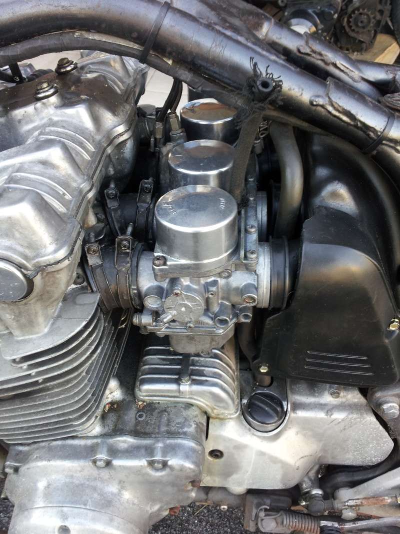

| LES CARBUS PASSES AUX ULTRA SONS MONTAGE DE KITS DE CARBUS JOINTS ET POINTEAUX NEUFS  LES CHAPEAUX AU POLISSAGE POUR VIRER LA MERDE DE VERNIS HONDA  TOUT EST REMONTE CELA FONCTIONNE DEJA BEAUCOUP MIEUX RESTE A REPLACER LA BOITE A AIR   A+ YVES |

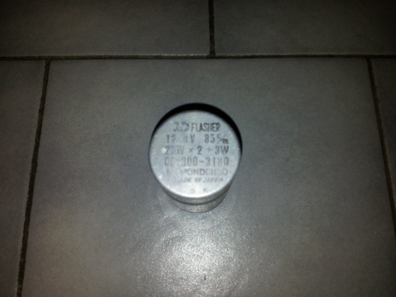

| SUITE DES INVESTIGATIONS LES PROBLEMES ELECTRIQUES DUS A L AGE ET AUX BRICOLAGES LES CLIGNOTANTS ETAIENT EN COURT CIRCUIT ET LA CENTRALE MONTEE A L ENVERS POUR INFO SUR UNE CENTRALE CLIGNOTANTE IL Y A 2 LETTRES B POUR BATTERIE ET L POUR LIGHT  C EST MIEUX DE RESPECTER LE MONTAGE CORRECT LE B COTE ALIMENTATION APRES FUSIBLE LE L COTE RETOUR AU COMMODO ET AMPOULES ENSUITE LES CLIGNOTANT DE MERDE A L AVANT AVAIENT DES AMPOULES DE 10W CE QUI FAIT QUE EVIDEMMENT CELA NE FONCTIONNE PAS SUR LA CENTRALE IL EST ECRIT 23WX2+3W SOIT 49W DE CONSOMATION POUR AVOIR UN CLIQUETIS REGULIER  AVEC 21W A L ARRIERE + 10W A L AVANT + 3W DE VOYANT ... ON EST A 34W LE CLIGNOTANT EST ALLUME FIXE EVIDEMMENT  C EST FOU COMME IL PEUT Y AVOIR DES IDIOTS DU VILLAGE INCAPABLE DE FAIRE UNE ADDITION POUR L ALLUMAGE C ETAIT ASSEZ FUN AU CHOIX 1 OU 2 OU 3 OU 4 CYLINDRES ... RAREMENT VU ???? LES BOBINES TESTEES OK 2 PANNES CUMULLEES 1 BOUGIE FANTAISISTE QUI FAIT UNE ETINCELLE QUAND ELLE VEUT OU QUAND ELLE PEUT ...  ET 1 BORNE D UN BOITIER OKI CONNU POUR SA PIETRE FIABILITE UNE BELLE VACHERIE A TROUVER  UNE COSSE ETAIT CASSEE DANS LA PRISE  REPARATION AVEC LA PINCE KIVABIEN   WALA C EST COMME NEUF UN VRAI SERTISSAGE COMME DANS LES CATALOGUES   A SUIVRE YVES |

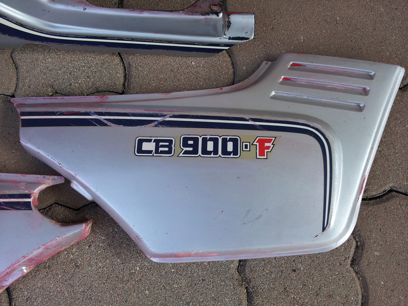

| SUITE  OUF C EST ENFIN FINI AVEC CETTE CONFITURE DE FRAISE .... J AI MEME RETROUVE LES DECO D ORIGINE   SUPER CELA VA ME PERMETTTRE DE PRENDRE MES REPERES POUR LES REPOSITIONNER APRES PEINTURE  LE GARDE BOUE AUSSI EST DEBARASSE DE SA PEINTURE HORRIBLE A SUIVRE YVES |

 | Sujet: Re: HONDA 900 BO FZ SC01 1979 Mer 31 Aoû 2016 - 7:35 | |
| Et sur le plastique , c'est quoi la méthode pour enlever le "surplus rouge" ? |
Nombre de messages : 13460 Age : 63 Localisation : REIMS Date d'inscription : 28/03/2007
 | Sujet: Re: HONDA 900 BO FZ SC01 1979 Mer 31 Aoû 2016 - 17:43 | |
| - rogerboldor a écrit:
- Et sur le plastique , c'est quoi la méthode pour enlever le "surplus rouge" ?
UNIQUEMENT DU DECAPEX EN GEL PAS LAISSER TROP LONGTEMPS AGIR JUSTE POUR FRISER LA PEINTURE A REPETER PLUSIEURS FOIS DANS MON CAS JE L AI FAIT EN 4 FOIS VU L EPAISSEUR ET RINCAGE A L EAU CHAUDE POUR ARRETER L ACTION CHIMIQUE ET SURTOUT PAS D ACETONE  A+ YVES |
