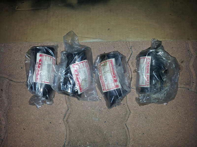

LE BAISE PATTES HABITUEL bom
1100 ZX DOMINATOR BOXER BIKE  - Page 6 20161139
DES BEAUX CAOUTCHOUC TOUT NEUFS ET BIEN SOUPLES ...CA AIDE
1100 ZX DOMINATOR BOXER BIKE  - Page 6 20161140
VOILA TOUT EST EN PLACE OUFFFFF albino
1100 ZX DOMINATOR BOXER BIKE  - Page 6 20161141
RESTE A REBRANCHER TOUS LES CIRCUITS D ESSENCE ET DE DEPRESSION w01

Yves, tu as procédé de quelle manière pour placer tes manchons d'air tout neufs ??? Question
1100 ZX DOMINATOR BOXER BIKE  - Page 6 Empty
MessageSujet: Re: 1100 ZX DOMINATOR BOXER BIKE    1100 ZX DOMINATOR BOXER BIKE  - Page 6 Icon_minitime31/12/2016, 12:49
JE COMMENCE PAR LE CENTRE EVIDEMMENT
JE LE RENTRE DANS LA BOITE A AIR AU 3/4
JE LE RESSORT POUR LE MONTER SUR LA RAMPE D IJECTION BIEN A FOND
JE POSE LE COLLIER COTE INJECTION BIEN SERRE
ET EN PASSANT LES DOIGTS PAR LA BOITE A AIR JE RESSORT LA COLLERETTE POUR QUE CE SOIT BIEN MIS EN PLACE
JE DIS PAS QUE C EST FACILE
JE DIS PAS QUE J AIME CA
MAIS YA PAS MOYEN DE FAIRE AUTREMENT ET ON SE FLINGUE TOUJOURS UN OU 2 DOIGTS DANS L OPERATION
CELA FAIT PARTIE DES AGACERIES DE CE MONTAGE
AVEC LA MISE EN PLACE DU CABLE DE GAZ tongue tongue tongue tongue
C EST A CHAQUE FOIS LA GROSSE GALERE
FAUT PAS AVOIR ABUSE DU CAFE Wink
CAR PLUS TU T ENERVES PIRE C EST I love you
BON COURAGE

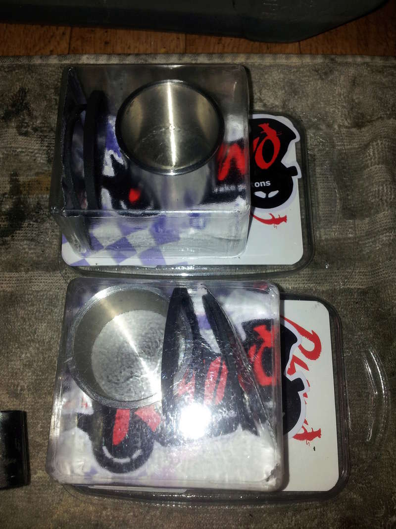

REMISE A NEUF DES ETRIERS DE FREINS
1100 ZX DOMINATOR BOXER BIKE  - Page 6 20161213
NETTOYAGE DES GORGES DE JOINTS A LA DREMEL AVEC UNE BROSSE NYLON MONTEE SUR FLEXIBLE
VOILA LE PUZZLE
1100 ZX DOMINATOR BOXER BIKE  - Page 6 20161215
LES JOLIS PISTONS EN INOX AVEC LES JOINTS NEUFS MADE IN UK Cool !!! JUSTE AVANT LE BREXIT Sad

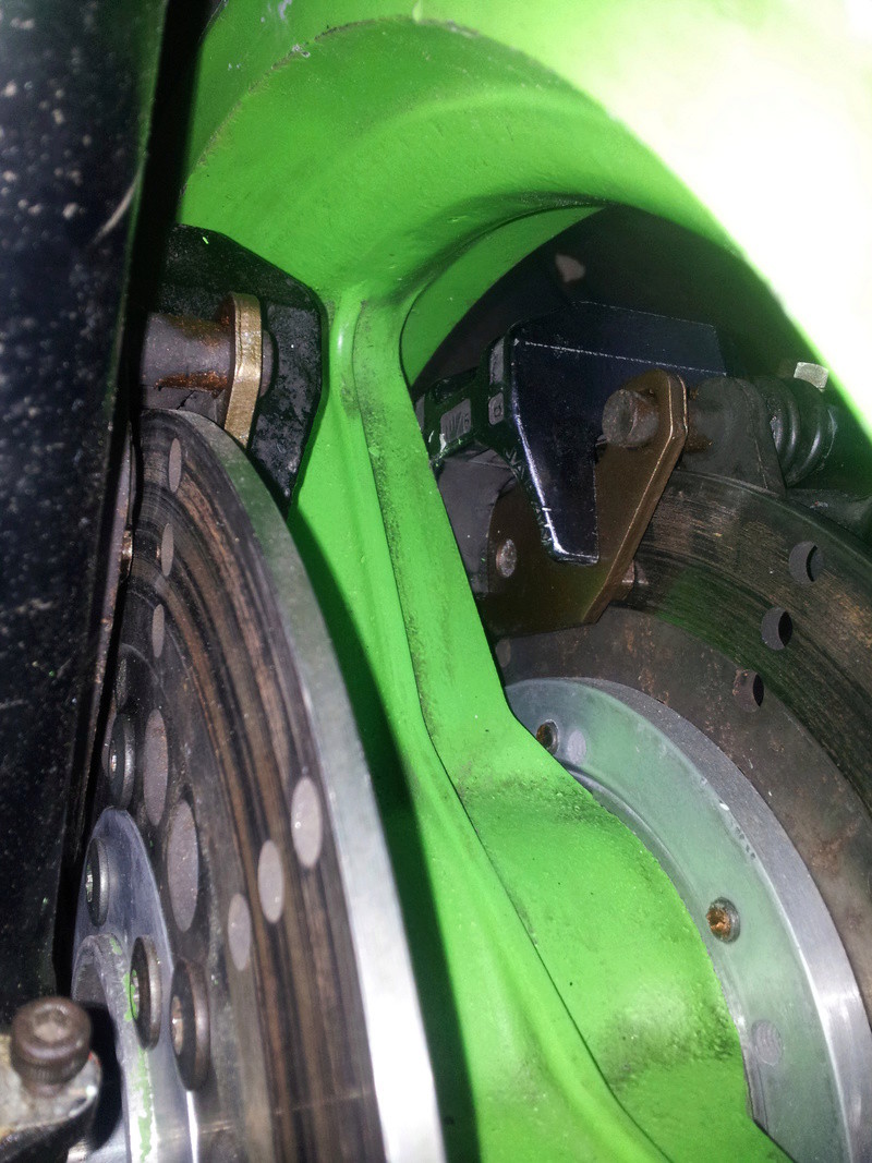

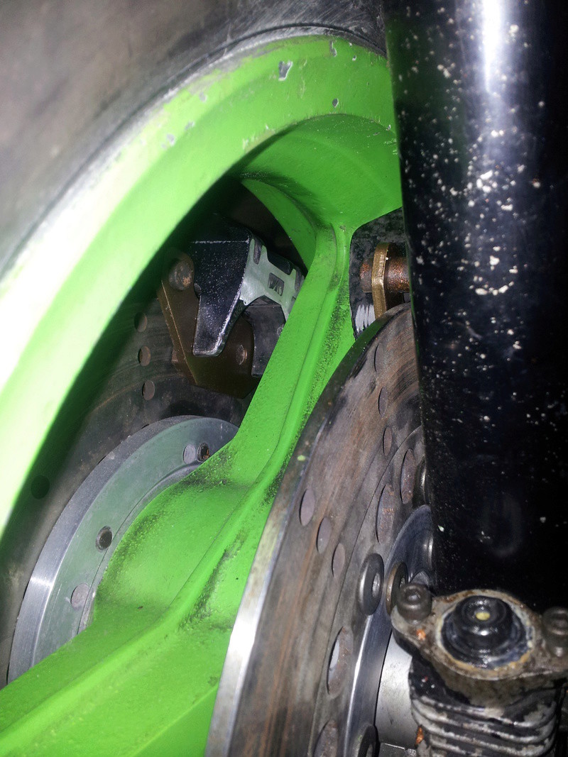

VOILA TOUT EST REMIS A NEUF ET EN PLACE
SOUCIS AVEC LES PLAQUETTES NEUVES CELA FROTTE LES BATONS DE LA ROUE DE 16
DEJA QUE C EST COTON A MONTER
IL FAUT MONTER LA PLAQUETTE INTERIEURE APRES AVOIR PASSE LE DISQUE EN PLACE
1100 ZX DOMINATOR BOXER BIKE  - Page 6 20170111
RESULTAT IL FAUT REUSINER 1 MM SUR CHAQUE ETRIER
MessageSujet: Re: 1100 ZX DOMINATOR BOXER BIKE    1100 ZX DOMINATOR BOXER BIKE  - Page 6 Icon_minitime1/1/2017, 17:27
La peinture des roues est trop épaisse casse
Si la place au milieu de l'étrier est suffisante,tu peux usiner la portée du morceaux arrière sans toucher à la peinture Question

MessageSujet: Re: 1100 ZX DOMINATOR BOXER BIKE    1100 ZX DOMINATOR BOXER BIKE  - Page 6 Icon_minitime1/1/2017, 18:22
VOILA TOUT EST RENTRE DANS L ORDRE
UN COUP DE FRAISAGE ET UN COUP DE BROSSE
AVEC 1 MM DE JEU POUR PAS AVOIR DE SURPRISE  w01
1100 ZX DOMINATOR BOXER BIKE  - Page 6 20170112
UN PETIT COUP DE PEINTURE HT SATINEE ET CE SERA INVISIBLE Cool !!!

SUITE DU FREINAGE
DEMONTAGE COMPLET DE TOUTE L ARAIGNEE NETTOYAGE A L ALCOOL A BRULER
ET REMONTAGE AVEC DES JOINTS NEUFS albino
LE DEMONTAGE DES VIS TETE FRAISEES DES COUVERCLES DE MAITRE CYLINDRE EST TOUJOURS UN GRAND MOMENT
DECAPEUR THERMIQUE ET TOURNEVIS A CHOC INDISPENSABLE tongue
UN PETIT COUP DE RODOIR POUR FAIRE PROPRE
GRAISSAGE DES PISTONS A LA GRAISSE SPECIALE POUR FREINS
ET C EST COMME NEUF
