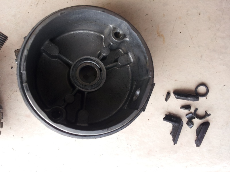

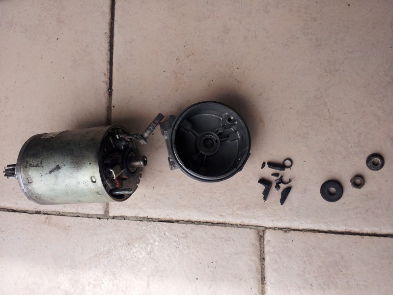

VOILA SUITE A UN COURT CIRCUIT LE DEMARREUR DE LA SUZUKI GSX 1100 EST ABIME
J AI REPASSE LE COLLECTEUR AU TOUR
remise en etat demarreur NIPON DENSO  20140733
ET CHANGE LES CHARBONS
AINSI QUE LES RESSORTS QUI AVAIENT BLEUI ET PERDU TOUTE ELASTICITE  bom
PAR CONTRE IL ME MANQUE L ISOLANT DE LA COSSE D ALLIMENTATION QUI EST EN MIETTES
remise en etat demarreur NIPON DENSO  20140731
remise en etat demarreur NIPON DENSO  20140732
SI QUELQU UN POSSEDE CETTE PIECE EN ETAT SUR UN DEMARREUR MORT JE SUIS INTERESSE  angel
CETTE PIECE EST EN BAQUELITE TRES FRAGILE ELLE EXPLOSE SI L ON FORCE DESSUS AU DEMONTAGE  affraid
SANS CETTE PIECE LA COSSE D ALIMENTATION EST EN COURT CIRCUIT ET LE DEMARREUR FUME  pale
MERCI D AVANCE

SUITE
LE PLUS SIMPLE LA PIECE D ORIGINE SUZUKI
ENCORE DISPONIBLE ... LE PLUS DIFFICILE ETAIT DE LA RETROUVER AVEC LE BON NUMERO SUR LE PART LIST Very Happy
remise en etat demarreur NIPON DENSO  20150113
REMONTAGE
remise en etat demarreur NIPON DENSO  20150114
RESULTAT APRES TEST SUR LA MACHINE DEMARREUR COMME NEUF  albino
