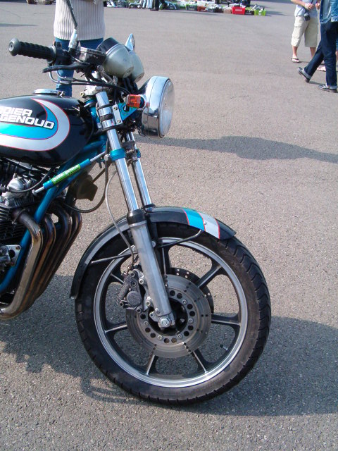

CAFE RACER C EST PAS TUNING ....
900 Z .............. KK production Hpim3510
900 Z .............. KK production Empty
MessageSujet: Re: 900 Z .............. KK production   900 Z .............. KK production Icon_minitimeSam 28 Avr 2007 - 21:50

ON DETAILLE ...
AVANT
900 Z .............. KK production Hpim3511
FREINAGE BREMBO MODELE BMW:( ROUE AVANT 1000 J
GDB Z1R
PATTES DE PHARE TOMASELLI
ARRIERE
900 Z .............. KK production Hpim3512
BRAS OSCILLANT ET POT MARTIN ROUE ARRIERE ET FREINAGE 1000J
SELLE GIULIARI BLANCHE
