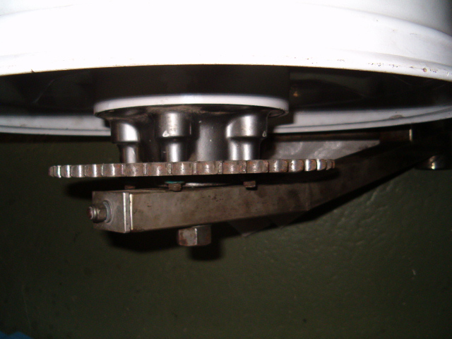

BON C EST PAS LE TOUT MAINTENANT QU IL Y A DES FREINS A L AVANT w01 Cool !!! Cool !!!
FAUT PTETE PAS QUE CA PATINNE A L ARRIERE POUR LANCER LE JOUET
QUAND ON ENROULE LE CABLE DES CR35 innocent innocent innocent
AVEC LA MOULINETTE QU ON LUI PREPARE Wink Wink Wink
DONC EN CLAIR FAUT DE LA GOMME SUR LE TARMAC
UNE BELLE JANTE EN 18 REGLEMENT OBLIGE
ET LE BRAS OSCILLANT KIVABIEN
ET C EST REPARTI POUR UN TOUR
VOILA LE CHALENGE
PROBLEME LA JANTE N EST MEME PAS DANS L AXE DU BRAS OSCILLANT QUE LA COURONNE
USINE DEJA LE TUBE GAUCHE tongue tongue
JE TE PARLE MEME PAS DE LA LIGNE DE CHAINE .... affraid affraid affraid affraid affraid
BEAU GOMMARD POUR VRAIE MACHINE DE COURSE Hpim5010
ON DOIT ETRE A RIEN MOINS QUE 17 MM DU BUT :face: :face:
VA FALLOIR TAILLER DANS LE BOIS DUR D UNE FORCE Question

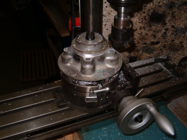

ON A PAS PEUR
TOUT EST BRELE SUR LE PLATEAU DIVISEUR
ET LA FRAISE ATTAQUE AVEC DES PASSES DE 5 MM pirat pirat pirat pirat
BEAU GOMMARD POUR VRAIE MACHINE DE COURSE Hpim4910
A PAS PEUR silent silent silent
A SUIVRE

DESOLE MAIS SUR CE COUP LA MON TOUR N EST PAS ASSEZ PUISSANT ET LES CHOCS ESQUINTENT MES OUTILS SUR DES PIECES COMME CELA
DONC JE PREFERE DEGROSSIR LES BOSSAGES A LA FRAISE ET AU PLATEAU DIVISEUR SURTOUT QU IL Y EN A GROS A ENLEVER 17 MM
ENSUITE FAUT QUE JE FASSE UN MONTAGE POUR FINIR LA PROTEE DE COURONNE AU TOUR BIEN SUR
CAR JE NAI QU UN MANDRIN 3 MORS DE 100 MM No No
C EST SUR SI J AVAIS UN TOUR GALLIC ET UNE FRAISEUSE HURON CELA SERAIT PLUS FACILE banana1 banana1 banana1
MAIS JE FAIS AVEC LES MOYENS DU BORD ET C EST DEJA PAS MAL POUR MON BUDGET pacontent01 pacontent01

BON BE C EST PAS LE TOUT
LA JANTE EST DEDANS ET CENTREE Very Happy Very Happy
LE PORTE COURONNE A SUPPORTE LE TRAITEMENT DE CHOC innocent innocent
BEAU GOMMARD POUR VRAIE MACHINE DE COURSE Hpim5015
ET LA LIGNE DE CHAINE EST BONNE albino albino
BEAU GOMMARD POUR VRAIE MACHINE DE COURSE Hpim5013
LES ROULEMENTS SONT RECALES EN LATERAL
BEAU GOMMARD POUR VRAIE MACHINE DE COURSE Hpim5014
ME MANQUE PLUS QUE L ENTRETOISE INTERMEDIAIRE
INTERNE AU PORTE COURONNE POUR CALLER LE TOUT DANS LE BRAS
J ATTENDS QUE JEAN YVES M APPORTE LE MORCEAU SOUS PEU Sad Sad
RESTE A FAIRE LA PATTE SUPPORT DE L ETRIER ARRIERE ET LE POSITIONNER SUR LE DISQUE
AVEC LE TIRAND
A SUIVRE
PS :POUR LES OBSERVATEURS VOUS POURREZ CONSTATER QUE LE BRAS OSCILLANT N A PAS TOUT A FAIT LA TRONCHE D UN Z 900 D ORIGINE casse casse casse casse casse
ET POUR CEUSSE QU AVAIENT LE TRAC POUR LA LARGEUR DU GOMMARD
FORCE EST DE CONSTATER QU ON PEUT ENVOYER DU GROS banana1 banana1 banana1 banana1

mmmmmhhh.... n'empeche que je veux voir la meme photo que celle du bras + jante avec le pneu de 150 monté... tof01 Sad
ça va passer p'tète... mais juste... mouais1 à moins que je ne me rende pas bien compte sur la photo... mouais1
'tout cas... ça promet... albino
bub'
BEAU GOMMARD POUR VRAIE MACHINE DE COURSE Empty
MessageSujet: Re: BEAU GOMMARD POUR VRAIE MACHINE DE COURSE   BEAU GOMMARD POUR VRAIE MACHINE DE COURSE Icon_minitime11/1/2008, 00:04
bub'
Idea Idea Idea c'est vrai que sur la photo, il ne reste qu'un trou de souris Wink mais ça doit le faire albino albino albino
