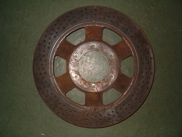

VOILA CE QUE L ON PEUT TROUVER SUR NOS MACHINES SPECIALES
EN COMMENCANT PAR LES PLUS PRESTIGIEUX LES SERIE OR RACING A FRETTE ALU AVEC UN FORT POURCENTAGE DE MAGNESIUM
EXISTENT EN 240 260 280 ET 300 MM
MONTES EN GENERAL SUR DES MACHINES DE COMPETITION
LA FRETTE ALU EST REDUITE VRAIMENT AU MINIMUM 246 GRAMMES BREMBO FIXES FONTE COMMENT LES RECONNAITRE  26876
LES PISTES FONTE FONT 5.4 MM VOIRE 5 MM DANS CERTAINS CAS affraid
BREMBO FIXES FONTE COMMENT LES RECONNAITRE  Disque10
LES SERIE OR A FRETTE ALU ALLEGEE MAIS AVEC DEJA QUELQUES RENFORTS
EXISTENT AUSSI 240 260 280 ET 300 MM
MONTES EN GENERAL SUR DES MACHINES DE COMPETITION OU DES MACHINES D EXCEPTION
LA PISTE EN FONTE EST FINE EN GENERAL 5.5 MM ET PERCEE POUR LIMITER LE FADING
BREMBO FIXES FONTE COMMENT LES RECONNAITRE  74000610
IL EXISTE MEME DES REFABRICATIONS DES PISTES EN ACIER
BREMBO FIXES FONTE COMMENT LES RECONNAITRE  Brmkqj10
LA VERSION FRETTE ALU PISTE FONTE VERSION STANDARD C EST TRES BEAU AUSSI EFFICACE MAIS UN POIL PLUS LOURD
ON LE TROUVE SOUVENT SUR LES TRES BELLES MACHINES DE ROUTE DES ANNEES 70/80
ET SUR LES KITS DE FREINAGES PROPOSES EN SECONDE MONTE PAR SEMC A L EPOQUE
LE PERCAGE EST UNE OPTION SUR CES MODELE PRISE PAR LES CLIENTS DANS 90% DES CAS
EPAISSEUR 5.5 MM ET POIDS 2115 GRAMMES
BREMBO FIXES FONTE COMMENT LES RECONNAITRE  Disque11
LA VERSION FRETTE ALU FONTE PLEINE PLUS EPAIS ET BEAUCOUP PLUS LOURD
ON LE TROUVE SUR LES DUCATI GUZZI ET LAVERDA DES ANNEES 70 PLUS EPAIS EN GENERAL 6.8 MM
RARES EN 300 MM ON LES TROUVES PLUTOT EN 280 MM
CEUX CI EN 280 MM FONT 2295 GRAMMES
BREMBO FIXES FONTE COMMENT LES RECONNAITRE  Disque12
LES VERSION FONTE MONOBLOCS TOUJOURS FABRIQUES ET MONTES EN PARTICULIER SUR LES MARTIN PENDANT DES ANNEES
EN 300 MM DE DIAMETRE EPAISSEUR 6.5 MM
BEAUCOUP MOINS CHERS ET PLUS LOURDS 2405 GRAMES
EXISTENT AUSSI SANS LES PERCAGES QUI SONT UNE OPTION
BREMBO FIXES FONTE COMMENT LES RECONNAITRE  Disque13
TOUJOURS COMMERCIALISES PAR GMP ET D AUTRES ...
CEUX CI SONT SANS LES PERCAGES BREMBO FIXES FONTE COMMENT LES RECONNAITRE  615257
BREMBO FIXES FONTE COMMENT LES RECONNAITRE  C344_110
WALA

merci , mais je ne reconnait pas les miens BREMBO FIXES FONTE COMMENT LES RECONNAITRE  97476
BREMBO FIXES FONTE COMMENT LES RECONNAITRE  08112010
les perçages sont différents

SERIE OR PERCAGE HONDA 5 TROUS BREMBO FIXES FONTE COMMENT LES RECONNAITRE  883385
TU REMARQUERAS QUE J AI MOI AUSSI DANS LE PHOTOS MIS UNE VERSION HONDA BREMBO FIXES FONTE COMMENT LES RECONNAITRE  753587
PARMI LES KAWA LAVERDA ET MARTIN ... PAS DE SECTARISME DE MA PART BREMBO FIXES FONTE COMMENT LES RECONNAITRE  775335
POUR LES SUZ ILS SONT MONTES SUR LES JANTES ...

Suspect TROUS SUR LE DISQUE PAS D ORGINE BREMBO No
PISTE PLEINE REPERCEE PAR LE CLIENT SI C EST BIEN FAIT PAS DE SOUCIS
BIEN VERIFIER QU IL N Y AIE PAS DES DEPARTS DE CRIQUES pale

LES CRIQUES SONT DE PETITES FISSURES QUI SE VOIENT A LA LOUPE UNE FOIS LE DISQUE BIEN PROPRE
OU PAR RESSUAGE ON PASSE UN PRODUIT COLORE QUI MET EN EVIDENCE LES FELURES BREMBO FIXES FONTE COMMENT LES RECONNAITRE  615257
C EST TRES DANGEREUX SUR LES DISQUES FONTE CAR ILS RISQUENT D ECLATER EN MIETTES
C EST SOUVENT DU A DES PLAQUETES NON ADAPTEES A LA FONTE QUI LES FONT CHAUFFER ENORMEMENT
OU UN UN CHOC THERMIQUE LE SEAU D EAU SUR LES DISQUES ROUGES A CAUSE D UN ETRIER BLOQUE PAS EXEMPLE
EST FATAL
