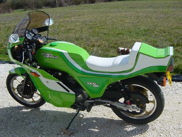

SALUT FRED
CE SONT DE BELLES PIECES DE PROVENANCE GG SANS AUCUN PROBLEME
POUR MOI A MOINS DE SURPRISE OU D ADAPTATION AUCUNE DE CES PIECES NE SE MONTE SUR LES KAWA Z 900 Z 1000 A KICK
ELLES NE CORRESPONDENT D AILLEURS PAS A L EPOQUE
POUR LE CARENAGE ET LE MONTAGE DE LA TETE DE FOURCHE EN ALU
C EST PREVU POUR LES 1000 J 1000 R
MAIS ACCESSOIREMENT CELA POURRAIT SE MONTER SUR UN 1100 GPZ B1 OU B2
LES MONTAGES DES CLIGNOTANTS SONT DE PROVENANCE CITROEN DIANE
OU ALPINE BERLINETTE POUR LES FORTUNES Very Happy
CE CARRENAGE A ETE AUSSI FOURNI PAR KMF EN ACCESSOIRE SUR UNE PETITE SERIE DE MACHINE
ON LE VOIT DANS LE MOULAGE DU TABLEAU DE BORD QUI SEMBLE TE MANQUER ?
POUR LA COQUE C EST MOINS EVIDENT IL FAUDRAIT LE PRESENTER SUR UN CADRE DE 1000 J POUR VOIR CE QUE CELA DONNE
C EST BIEN PROBABLE QUE CELA SE MONTE
POUR LE GARDE BOUE AVANT C EST AUSSI UN MODELE GG QUI NECESSITE UN PONTET DE FOURCHE TELEFIX POUR SE MONTER
IL EST AUSSI PREVU POUR LES FOURCHES 1000 J 1000 R
ON LE RETROUVE EVIDEMMENT AUSSI SUR LES GG 1135
VOICI UN MONTAGE D EPOQUE SUR UNE BASE 1000 J
ON REMARQUERAS QUELQUES OPTIONS SUPPLEMENTAIRES
BULLE FUMEE HAUTE
RETROS VITALONI CALIFORNIA BLANCS
BRAS OSCILLANT GG ALU
JANTES ALU KAWA DE 1000 R DOREES
ET AMORTISSEURS KONI
Sur quel Kawa Ggo3_310
