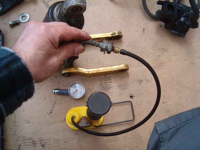

IL EST STRICTEMENT INTERDIT D UTILISER UN COMPRESSEUR LE VOLUME D AIR ETANT TRES FAIBLE LA PRESSION VA MONTER
TRES RAPIDEMENT ET EXPLOSER LES JOINTS
RACCORDEMENT AVEC POMPE A PIED DE VTT MODELE A 2 EUROS EN PLASTOC CELA SUFFIT
