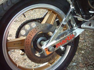

QUELQUES PRECISIONS
CE CADRE MARTIN N A PAS DE SOUDURES CE SONT TOUTES DE BRASURES
POUR L ABANDON DE LA FOURCHE INVERSEE C EST UNE SAGE DECISION DANS LE CAS D UNE MACHINE
PLUS PROCHE DE L ORIGINE D EPOQUE
POUR LES ROUES IL EST FACILE DE TROUVER LES ROUES MARTIN A 3 BRANCHES COPIES DES DYMAG
CERTAINE JANTES MARTIN EN VERSION DEMONTABLES SONT TRES REUSSIES
POUR LES ROUES A RAYON CELA FAIT BIEN VINTAGE MAIS EST ASSEZ ANACHRONIQUE POUR UNE MACHINES DES
ANNEES 85 A 90

POUR LES ROUES MARTIN DE CETTE GENERATION DE MACHINE C EST CELLES CI QUI SONT LES PLUS ADAPTEES
VERSIONS DEMONTABLES
ATTENTION SUR LES 3 VIS DE FIXATION DU CENTRE A 3 BRANCHES SUR LA JANTE
IL FAUT REMPLACER LA VIS CENTRALE PAR UN GOUPILLE SI CELA N A PAS DEJA ETE FAIT POUR LES SECURISER
1200xjr transformée sauce MARTIN Martin13
L AUTRE ALTERNATIVE EST LA VERSION MONOBLOC COPIE DES DYMAG MAIS EN ALU CHEZ MARTIN
1200xjr transformée sauce MARTIN Martin14
