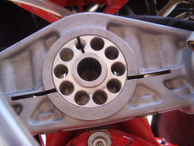

GRACE A ARNAUD QUI FAIT LES POUBELLES DU CASTELET ... J AI ENFIN TROUVE LE MONTAGE BIMOTA
DU CARENAGE DE KB1 QUI ME MANQUE DEPUIS 10 ANS ...

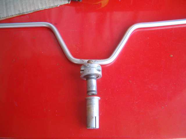

VOILA LE MATOS
BIMOTA KB1  - Page 2 Bimota48
LA PIECE DU BAS EST DEPUIS 10 ANS DANS UNE BOITE SANS SAVOIR COMMENT ELLE SE MONTE
LE RESTE SORT DES POUBELLES
LE TUBE SUPERIEUR EST TORDU ET COUPE A DROITE DE 15 MM PAS GRAVE ET FACILE A REMETRE EN ETAT
VOICI L ETAT ACTUEL AVANT MONTAGE DES PIECES
BIMOTA KB1  - Page 2 Bimota50
VOICI LA PIECE EN PLACE AVEC LA VIS TETE FRAISEE POUR L EXPANSER DANS LA COLONNE DE DIRETION

LE MONTAGE DE LA PIECE TOURNANTE SUPPORT DU TUBE
BIMOTA KB1  - Page 2 Bimota51

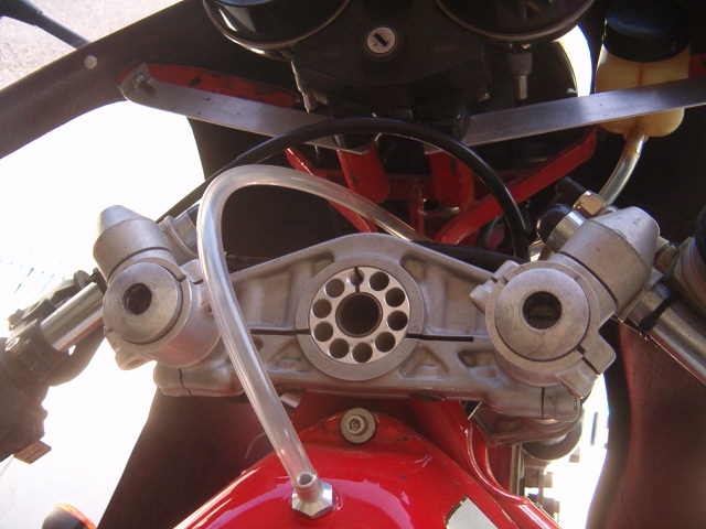

VOICI DE FACE
BIMOTA KB1  - Page 2 Bimota53
VOICI TOUT LE MATERIEL MONTE ET REGLE ON DEVINE LA REPARATION A DROITE AVEC LE PETIT TUBE DE LONGUEUR 15 MM
BIMOTA KB1  - Page 2 615257
BIMOTA KB1  - Page 2 Bimota52
IL NE ME RESTE PLUS QU A TROUVER 2 VIS M6X30 PRESENTABLES POUR FINALISER
ENCORE MERCI A ARNAUD POUR SES TROUVAILLES
D AUTANT QUE CE MONTAGE N EXISTE PAS SUR LE PART LIST BIMOTA KB1 ET EST EXTREMEMENT RARE A TROUVER EN PHOTO
POUR LE REFAIRE A L IDENTIQUE ...LA C EST BEAUCOUP MIEUX CE SONT LES PIECES ORIGINALES BIMOTA KB1  - Page 2 753587
VOILA COMMENT COMPLETER UNE MOTO RARE GRACE A CE FORUM BIMOTA KB1  - Page 2 26876 DE FACON PLUTOT CURIEUSE BIMOTA KB1  - Page 2 615257
