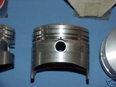

POUR DES PISTONS COMME CEUX CI
C EST PREVU POUR
DANS LE SACHET ROUGE TEFLON BUTTON 276328
TEFLON BUTTON Piston10
KIT RUSS COLLINS D EPOQUE AVEC TAMPONS EN TEFLON TEFLON BUTTON 615257
TEFLON BUTTON Piston11
TEFLON BUTTON Piston12
AVEC LES PISTONS CI DESSOUS
YOSHIMURA USINE ... CA MARCHE PAS
LES TAMPONS NE SERONT PAS RETENUS PAR LA CHEMISE ...
TEFLON BUTTON Yoshim10
WALA
