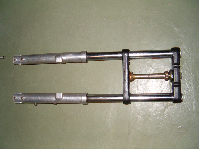

VOILA LES MORCEAUX DE DEPART albino
UNE FOURCHE MARZO DE 38 AVEC TES DE FOURCHE DROITS POUR AVOIR UNE CHASSE RAISONNABLE

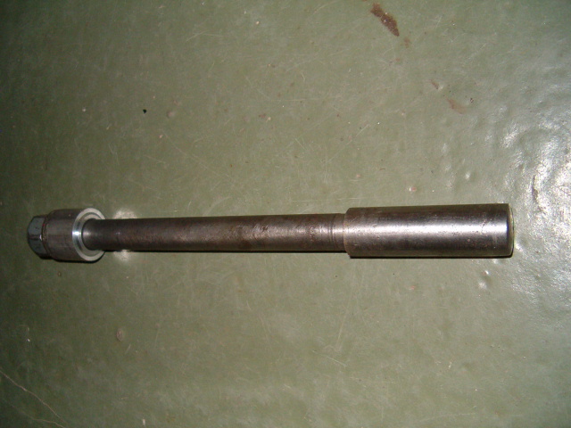

MONTAGE DE L AXE D ORIGINE DANS LA FOURCHE
DOMMAGE LE FILETAGE NE DEBOUCHE MEME PAS DE L AUTRE COTE mouais1
MONTAGE DE L AXE EN ACIER SUR LE TOUR ENTRE POINTES
ET MISE A LA COTE DU COTE GAUCHE DIRECTEMENT EN APPUIT SUR LA CAGE DE ROULEMENT INTERIEURE
CELA EVITE D AVOIR 2 ENTRETOISES QUI SE CASSENT LA GUEULE AU DEMONTAGE
ET DE LES INVERSER Razz Razz Razz

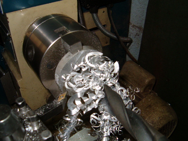

1/ USINAGE DES FRETTES EN ALU DE 7 MM CHACUNES A L INTERIEUR SUR LE TOUR
ET LA CONTENT QUE LA HAUTEUR DE BANC SOIT SUFFISANTE
GAFFE BIEN SUR AU VOILE
2/ USINAGE DE 2 ENTRETOISES MONTEES A LA PRESSE POUR REDUIRE LE DIAMETRE INTERIEUR
ET OBTENIR UN CENTRAGE PARFAIT DES DISQUES
GAFFE BIEN SUR AU SAUT
