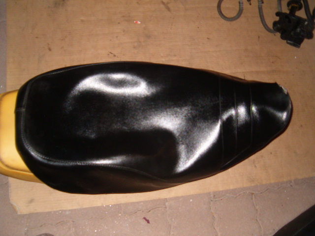

LA HOUSSE DE SELLE EST DEMONTEE POUR ETRE RECOUSUE AVEC UNE PIECE PROVENANT D UNE AUTRE SELLE DECHIREE A UN AUTRE ENDROIT
1100 ZX YVES  - Page 2 Hpim4430
 ON VOIT BIEN LA DECHIRURE  bom

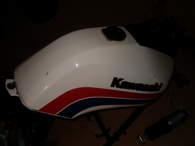

RESERVOIR COTE DROIT

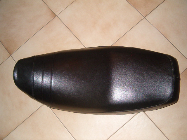

LA SELLE EST REFAITE
1100 ZX YVES  - Page 2 Hpim4441
SKAI AVEC LE MEME GRAIN RECUPERE SUR UNE AUTRE SELLE DE 750 TURBO FATIGUEE POUR FAIRE LA REPARATION
AVEC UNE JOLIE COUTURE FONDUE DANS LE DECOR THERMOSOUDE D ORIGINE
C EST PAS MAL DU TOUT ... FELICITATION A LA COUTURIERE MAISON  albino

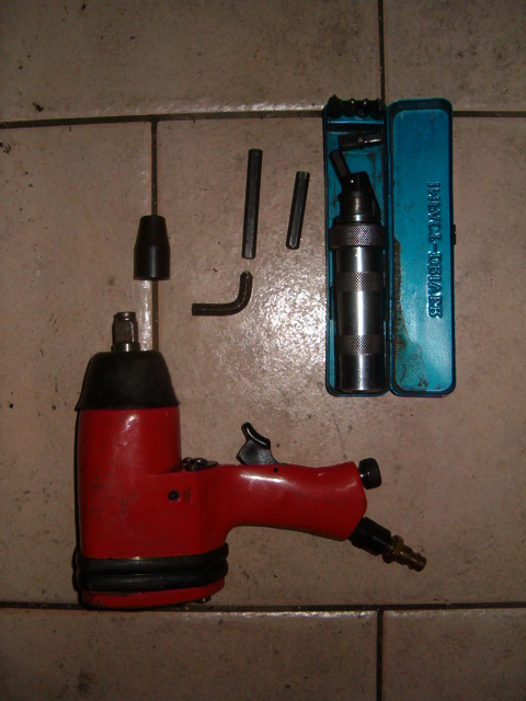

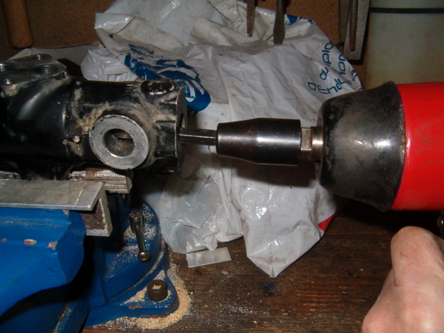

DES PETITES ASTUCES POUR LE DEMONTAGE DE LA FOURCHE
VOICI L OUTIL QUI VA BIEN
 1100 ZX YVES  - Page 2 Hpim4439
J AI SACRIFIE UNE CLE BTR DE 8 POUR EN FAIRE UN EMBOUT LONG
AUTRE PROBLEME RESOLU
C EST TRES COMPLIQUE DE TROUVER UNE DOUILLE 6 PAS DE 8 AVEC UN CARRE D ENTRAINEMENT EN 1/2''
QUI VA SUR LA GROSSE CLE A CHOC
J AI EU LA CHANCE DE TOMBER SUR UN TOURNEVIS A CHOC STANDARD QUI A JUSTEMENT CETTE DOUILLE HYPER RENFORCEE
EN H8
ET VOILA LE TOUR EST JOUE  Cool !!!
10 SECONDES POUR DEMONTER LES FOURCHES MEME AVEC LE FREIN FILET D ORIGINE
CELLE CI N AVAIT JAMAIS ETE DEMONTEE C EST LE PIRE
HABITUELLEMENT JE SUIS OBLIGE DE CHAUFFER POUR QUE CELA VIENNE
1100 ZX YVES  - Page 2 Hpim4440

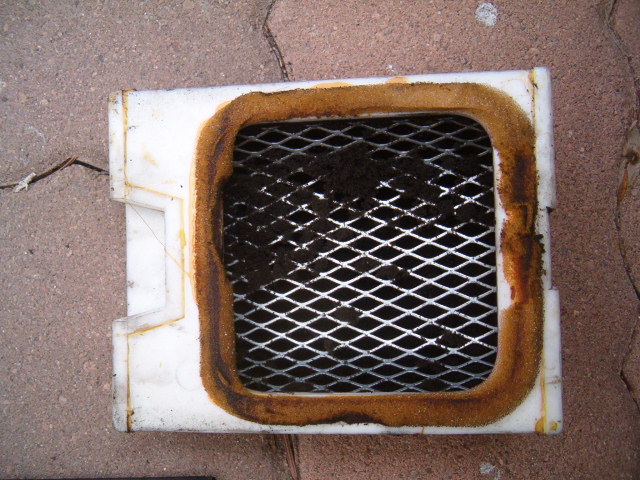

REMPLACEMENT DU FILTRE A AIR DONT LA MOUSSE SE DECOMPOSE
1100 ZX YVES  - Page 2 Hpim4455
PROBLEME TRES COURRANT SUR CES MODELES COMME SUR LA 750 TURBO
LA MOUSSE SE DETACHE EN MIETTE ET EST AVALEE PAR LE MOTEUR
C EST SOUVENT CATASTROPHIQUE AVEC LES SOUPAPES ENGLUEES ET LES SEGMENT COLLES
NE JAMAIS REDEMARRER CES MACHINES SANS L AVOIR REMPLACE PAR UN NEUF  bom OU MEME L AVOIR SUPPRIME TEMPORAIREMENT

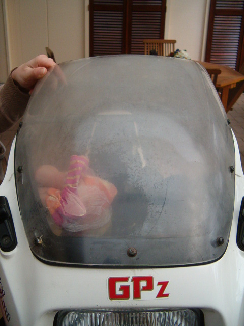

ENSUITE JE M OCCUPE DU MAITRE CYLINDRE
PONCAGE DE LA BULLE AU 1200 A L EAU
1100 ZX YVES  - Page 2 Hpim4457
PUIS 2000
AVANT POLISSAGE

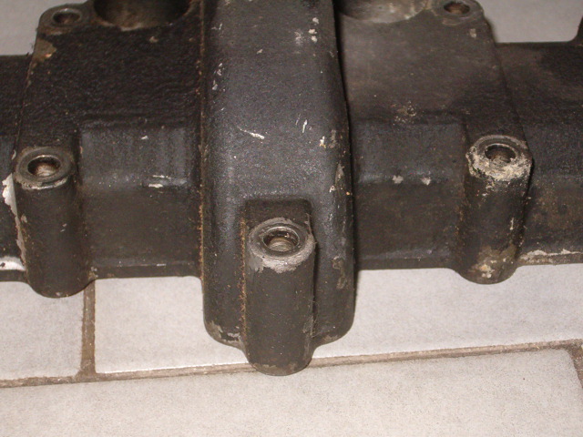

JE SUIS ENTRAIN DE REMONTER UN MOTEUR DE 1100 ZX ET COMME D HABITUDE LE CACHE AAC EST FENDU
EN CHERCHANT DANS LES VIEILLERIES JE SUIS TOMBE SUR CECI  Very Happy
UN CACHE AAC STANDARD C EST COMME CA
1100 ZX YVES  - Page 2 Hpim4516
J EN AI TROUVE UN COMME CECI  Question
1100 ZX YVES  - Page 2 Hpim4517
JE VOUS L ACCORDE IL EST EN RUINE MAIS LA CHOSE INTERESSANTE CE SONT LES 2 RENFORTS DE FONDERIE
QUELQU UN A DEJA REMARQUE CELA ET SI C EST LE CAS C EST SUR QUELLE MACHINE ?
1100 ZX A2 OU 1000 J3 PAR EXEMPLE C EST INTERESSANT A SAVOIR
ET QUAND C EST LE CAS IL Y A TOUJOURS LE PANNEAU D INTERDICTION DE STATIONNER A DROITE ? casse  casse  casse
COMME QUOI ON A BEAU BIEN LES CONNAITRE ET EN AVOIR MONTE ET DEMONTE DES DIZAINES ...
ON TROUVE TOUJOURS DE BRICOLES  tof01
1100 ZX YVES  - Page 2 Empty
MessageSujet: Re: 1100 ZX YVES    1100 ZX YVES  - Page 2 Icon_minitime3/5/2014, 07:49
oui, YVes, j'en ai trouvé sur mes moteurs des ZX
